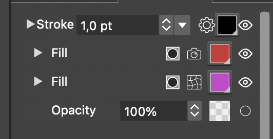

      Hello,
      Latest version 1.2.017
      I have the following fillings with effects.

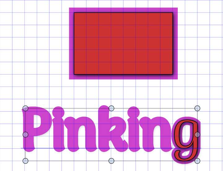

      But the complete filling effects are only applied to the last letter.

        @MajorTom Can be replicate here also. It is cearly a bug, I will try to fix this ASAP.
        If I recreate the text from scratch, then it renders correctly.
        • M Offline
          MajorTom
          @VectorStyler , one more thing is missed in the original text.
          First I created the rectangle and then copied the appearance to the text.
          perhaps that helps with finding the bug.
