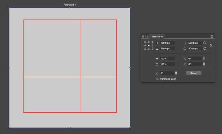

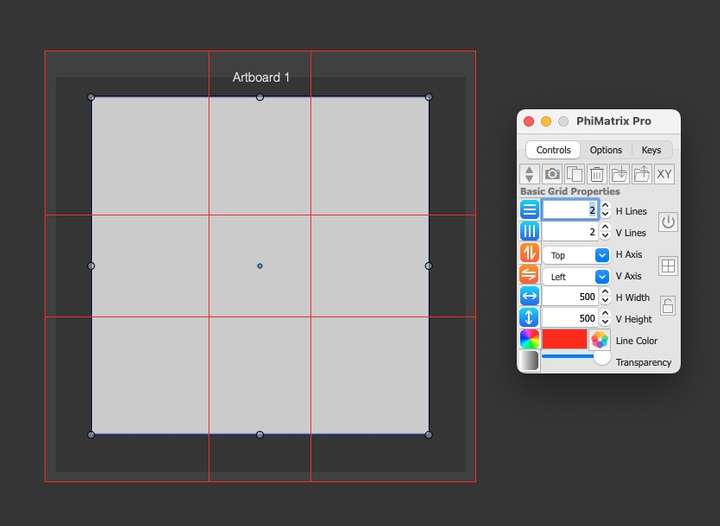

@VectorStyler The red golden ratio square overlay is physical 500x500 px and the grey square behind in VectorStyler equal to the artboard but appears wider

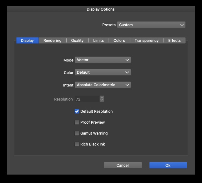

@creative I opened a bug on this. Can you check what resolution is set in the View -> Display -> Display Options
@VectorStyler It is 72 dpi

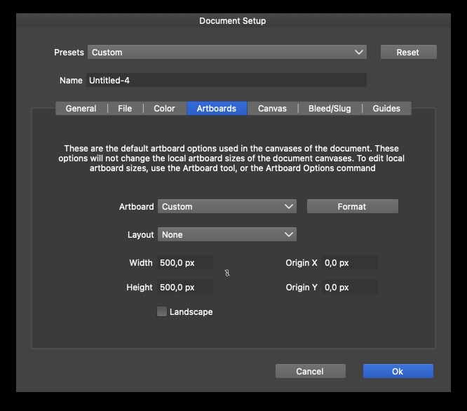

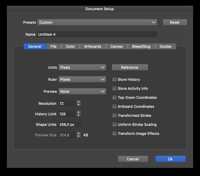

I am now experimenting with changing existing documents via the document setup from px to cm and from 72 dpi to 300 dpi resolution and back.
