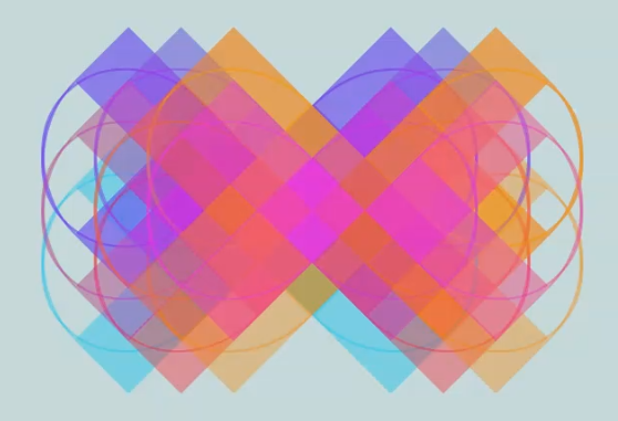

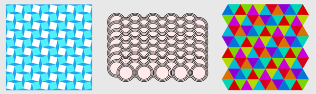

      Here Replica of the PatternNodes pattern i made with Nodebox, the right piece is from Nodebox Forum.
      Here a video showing the Nodes I used to recreate the PatternNodes pattern.

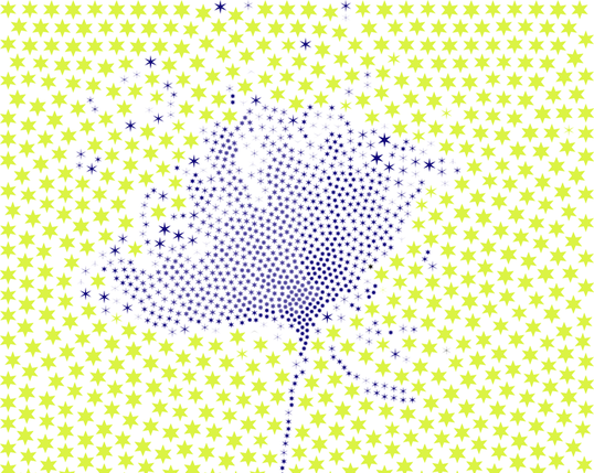

            Here a another picture made with that SVG Object Replace Node Tree in Nodebox.
            Will post a Video where i explain a few things and little more advanced Node Tree
            but it will take yet a little while.

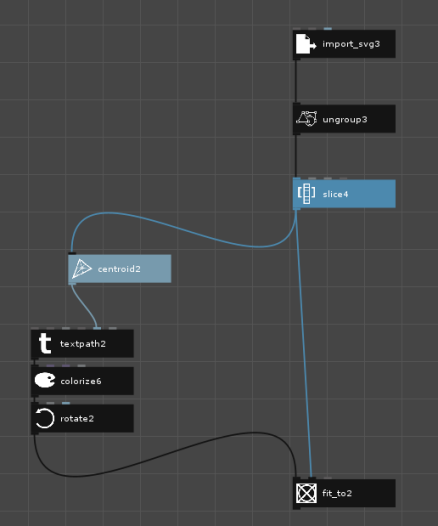

            This Picture below here shows how i made this in Nodebox, it is a more basic version which still works.
            To find that Nodes in Nodebox click on "New Node" on Top of that Panel there is a search Function.
            Will post a Video where i explain a few things and little more advanced Node Tree but it will take yet a little while.
            Here a Video how the Basic Node Tree works
            To use this Tree below:
            Click on the "Import_svg3" Node and choose a SVG File
            which containes multiple copies of one Object.
            You could create one in VS with the Repeater and export it as a SVG File.
            The "Textpath2" Node replace this Object with a Word then.
            To render this all double click (left Mouse Button) the "fit_to2" Node.
            Then you can export your Result as a SVG from Nodebox.
            Here the Node Tree, basic Version

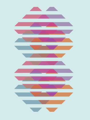

                VectorStyler - Nodebox comparison, creating patterns with letters
                A while ago I made a little Vectorstyler tutorial on how
                to create patterns with letters.
                In the meanwhile I did the same in Nodebox. Thought it
                might be interesting to see the different approaches.
                Note:
                Export your Nodebox result as a .PDF to preserve the
                colors and especially the transparency of your pattern.
                Here is the video of how I did it in VectorStyler.
                Here is the video of how to do it in Nodebox.
