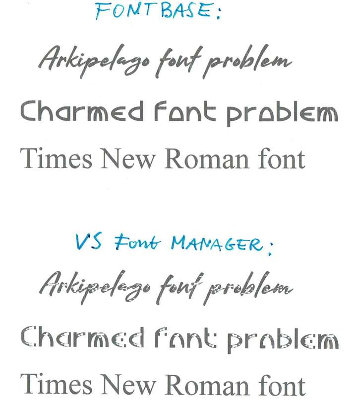

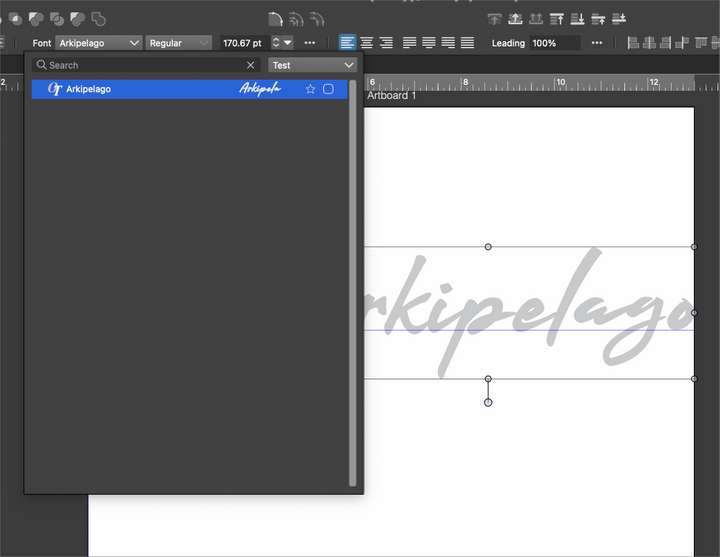

After using Arkipelago font in VS's font manager, white spots occurred on printed materials. After activating this font in Fontbase, everything is ok.
Printed and scanned text:

in case it helps, I made a new folder for fonts inside VS's font manager and added the font "Arkipelago" and did not have any display issues like in the photo from the original post.

@Boldline Thanks for checking but display is not a problem. The issue appears on paper after printing.

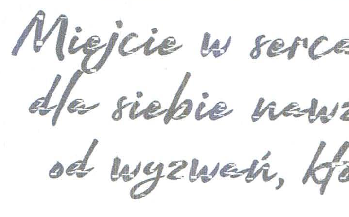

I've noticed that other (nonsystem fonts) also have this problem. Those are printed and scanned samples made by fonts activated with VS font manager and Fontbase:
Another app like MS Word prints those correctly (fonts activated in Fontbase).
