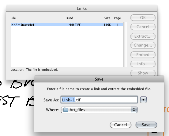

The Links panel in old FreeHand had an Extract button to save even un-named embedded images to a file, as shown below. Possible to do this in VS?
@Raven said in Linked file concept in VS overall works bad and unfinished:
I added this to the backlog.
