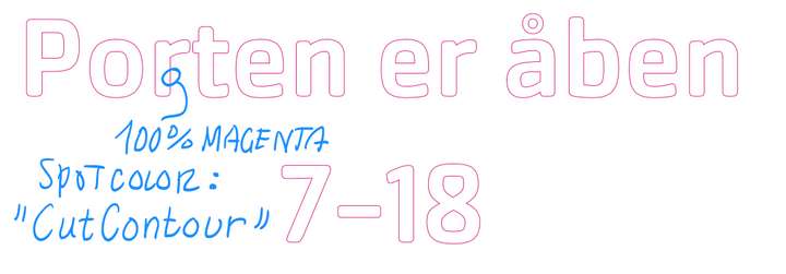

      I’m trying to generate pdf’s with spotcolors for cutting transfers on a Roland plotter. This demands a pdf-file with spot color CMYK 0x00 (100% magenta only) and spot color specifically named “CutContour”
      Yet attempting to do so in VS fails and the spot color change to cmyk 0000 (white or no color). However: The spot color name is preserved successfully.
      This is no problem in AI pdf's.
      Files attached. What am I doing wrong?
