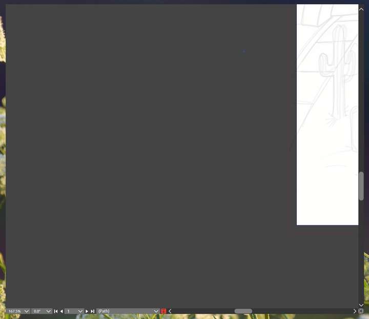

          I did check the demaximized behavior and was able to pull out the window normally. That window still has a menu, though I'm not sure if that is normal. I was able to change it to "Single Document View", but I did manage to "break" that window though by using Ctrl/Alt + Enter. (Standard key combination for leaving/entering full screen in Windows)
          It is resizable, but looks like this now:
          I wasn't able to reproduce it on video, but did some testing:
