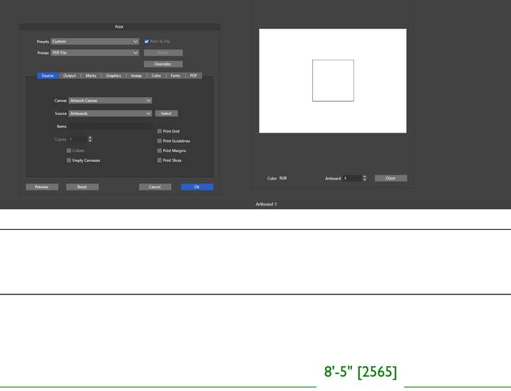

      After installing latest build (twice - I uninstalled and reinstalled)
      I can no longer print
      It recognises 2 artboards even though there is only one
      so even if i print 'all' artboards.. it will only print artboard one - as there is only
      .. but artboard '1' is a blank square (not created by me)!
      I can;t share my screen (confidential client info)
      But you can see that my artboard 1 is an A0 doc.. you can see a line and a green dimension line demonstrating..
      however when i click on print artboard 1 is a blank square
      Windows 11 Home 21H2

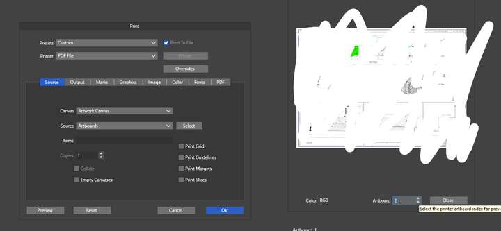

        here is artboard '2' - which doesn't exist
        sorry I had to scribble over actual file0_1719255111994_Screenshot 2024-06-24 195033.png

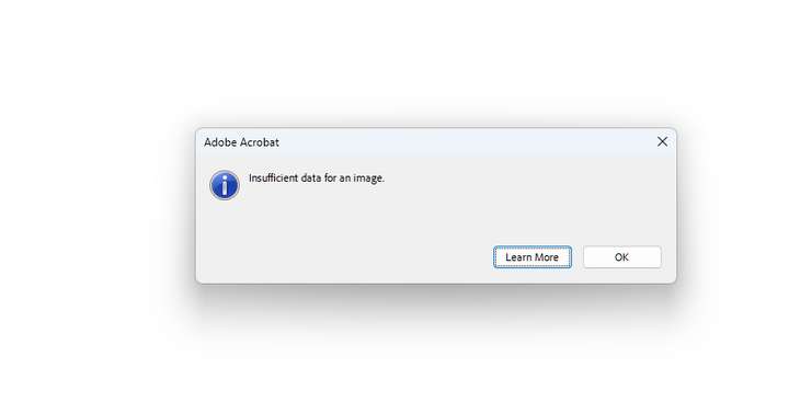

          printing just gets me this
          exporting the same

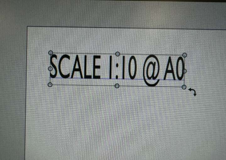

              btw I have also found that the text re-sizing handles are broken..
              I can't diagonally enlarge text (unless I do it back to front!)

                  FYI - I've just rolled back to 1.2.0.29 and all works fine.. so does look as if it was introduced in latest build
                  edit - no there's stil something wrong. Although the 'additional artboard ' issue has gone I am getting errors on PDF print-out 'insifficient date ' etc as above

                    About the text resizing: I tested it here and it seems to be working.
                    When you hover with the mouse over the round resizing knob, what cursor is shown?
                    This part seems to be again a workspace issue. Try resetting all to defaults.

                            ambros @VectorStyler
                            @VectorStyler said in Will no longer print:
                            I just created a new doc and text box to check and it all works as it should.. that 'test document' i posted above is where I saw the strange behaviour.. it might be that the file is corrupted or something ?
