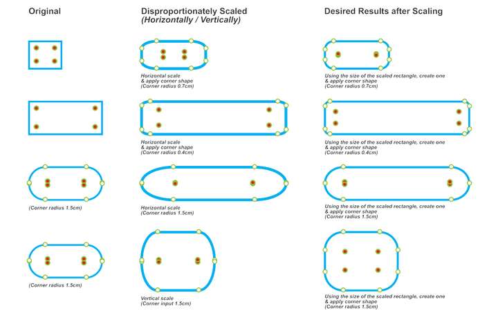

      1. Draw a rectangle
      2. Disproportionately scale the rectangle horizontally/vertically using the Transform Tool
      3. Apply a Round Corner Shape effect
      Notice how the rectangle's corners become distorted. It appears this distortion is caused by the shift in position of the Corner Editing Nodes relative to the object. Even when you attempt to scale horizontally/vertically rectangles which already have a Corner Shape applied, the undesirable distortion also occurs.
      Note that this behaviour is not something new.
      Can we at least have an option to lock the Corner Editing Nodes?

        I know I can convert to curves and use the Node Tool to achieve a favourable result, but at times I need to maintain the parametric shapes.

            @VectorStyler Please refer to the attached files.
            Notice and compare the positions of the Corner Editing Nodes with respect to their counterparts in the same row.

                @William-Kansepa It is recommended to use the shape panel to adjust the dimensions of the rectangle instead of using the transform panel. This way, you can avoid any distortion issues with the corners.
