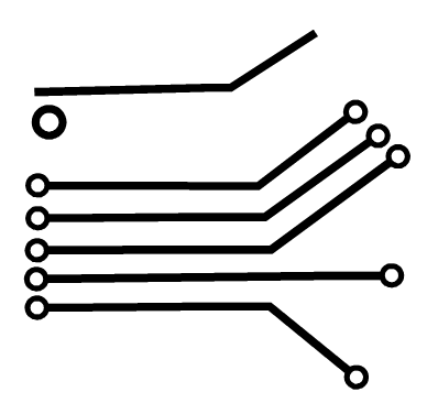

Here is an example from me, I once had the idea
that it could be useful for a circuit board like graphic design
so i made me this custom Arrow Head
