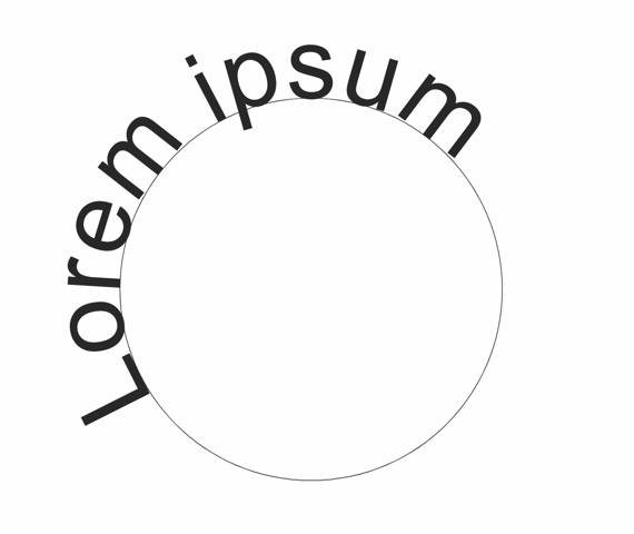

      Moving text along a path seems far more laborious than it should be. I tested this on two different macs running the newest build and had the same struggles
      Once the text is added, then switching over to the transform tool; attempting to move the live text along the path is non-responsive and occasionally works. for me, it's completely unusable at the present time.
      0_1722969808625_f7b514f1-fe88-4ed4-aaef-a59ab79aa696-CleanShot 2024-08-06 at 14.43.18.png
      S VectorStylerV 3 Replies Last reply Reply Quote 2
        Subpath @Boldline
        @Boldline
        The Text moving stutters while moving it manually
        seems at random positions
        as a workaround you can use the "Edit Options"
        in Panel Menu (pressing Shift in steps of 10)
        see video here

            @Boldline I opened a bug on this and will try to find a solution.
              @Boldline Seems to be working only when the mouse is close or over the outline shape.
              I will try to have this fixed for the next build.

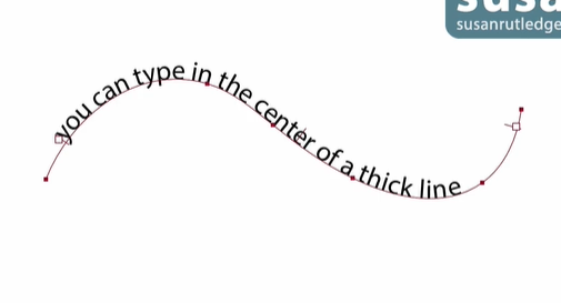

                Here is a link to a video of how the whole thing was solved in AI.
                https://www.youtube.com/watch?v=rdXSlxEYFwU&t=17s
                It uses a sort of text frame embedded in a path bounded by handles at the beginning and end of the text used for moving and aligning.
