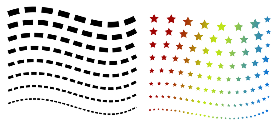

      This Tip is about a unsual use of "Dashed Lines"
      I mentioned this possibility already in another post. But I thought to put
      it also in the Tutorial section that users may have easier access to it.
      VectorStyler can assign dashes to a stroke. If we expand such a stroke
      we could replace the dashes with another shape
      Lets create a Blend between two strokes. Expand the Blend and ungroup them.
      Apply dashes to the Paths and expand the stroke then.
      Choose a shape now, any one will do and create a symbol from it.
      Select all dashes shapes go to Replace select your Symbol
      and voila you got the dashes replaced with any shape you like
      Here a Video which shows the steps
      it also shows how to add a gradient to it

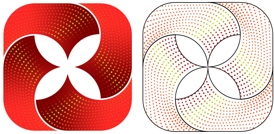

      made also the fill for this Pattern this way
