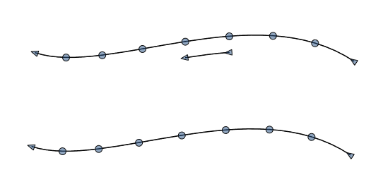

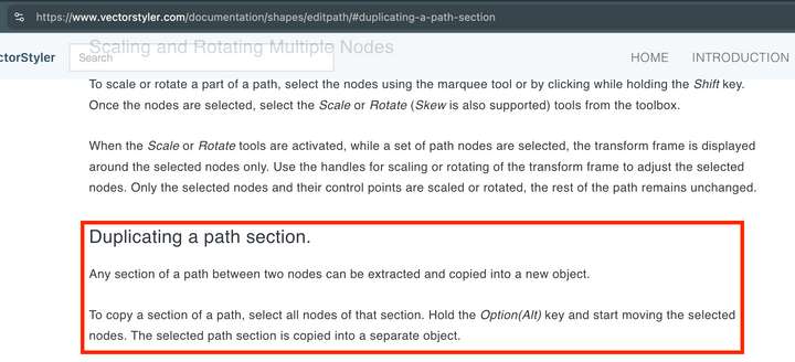

      I can't make this work. Is this procedure correct?
      https://www.vectorstyler.com/documentation/shapes/editpath/#duplicating-a-path-section

        @pentool Tested here and seems to be working: https://share.cleanshot.com/ySbtjwbJ
        Could be a modifier key settings change.

          Well, yes, it works because you selected all the nodes. Per the manual, it says "...any section of a path between two nodes..."
          I think the wording threw me off. I selected 2 nodes of a path but it doesn't work even though the manual says "between 2 nodes". I figured I have to select 2 nodes and drag the section. But it seems you have to select 3 nodes (at the minimum) for it to work.

                      VectorStyler @pentool
                      @pentool said in Duplicating a Path Section - per manual, doesn't seem to work:
                      Yes the wording might need to be changed. The two node selection case does something else (stretching rotating the path section).
