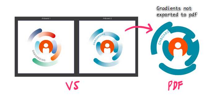

Masked mesh gradients --> bad pdf
Exporting masked mesh gradients returns pdf as depicted.
If any solution I’ll thankfully like to hear.If a bug I hereby want to report it. Files attached ...
0_1727438587392_onboarding-logo-260924-failed.pdf
0_1727438609514_onboarding-logo-260924.vstyler
@Raaskot I opened a bug on this and will try to replicate it.
@Raaskot It seems to be a bug, can be replicated here also. I will try to find a solution for this ASAP.
EDIT: found the root cause, not yet sure when the fix can be available. The problem is caused by using transparent colors in the mesh gradient (these are not supported by PDF).
I will try to fix this issue, but it might take some time.
