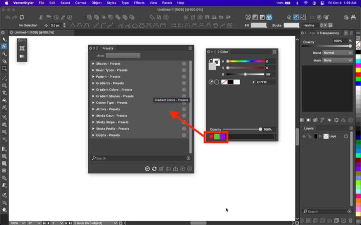

And finally, my understanding is that the difference between "styles" and "presets" is that when you modify a "style" all objects that have that particular style applied will reflect the change. So these colors (red, green, purple) are showing up in the color style row in the Color Panel (when you select "Show Color Styles" from the panel menu). However, it is clear that these are not STYLES because when you assign the same color to different objects and you edit the color, the change is only reflected in the selected object as opposed to all objects that uses that color (as in the case with color styles).
Forgot one more question. Why are the saved "Color Presets" are not showing up anywhere in the Presets Panel?
There are Gradient Presets, Gradient Color Presets, etc. You can save "Color Presets" (as I have demonstrated in one of the above videos) but there's no "Color Presets" to be found where I can see the list of my saved colors.
I think this aspect needs a rework as it is very confusing to know what goes where and how everything ideally things are saved and recalled. I always assumed features were implemented as needed and would get a rethink as time went on depending on overall usability and feedback.
