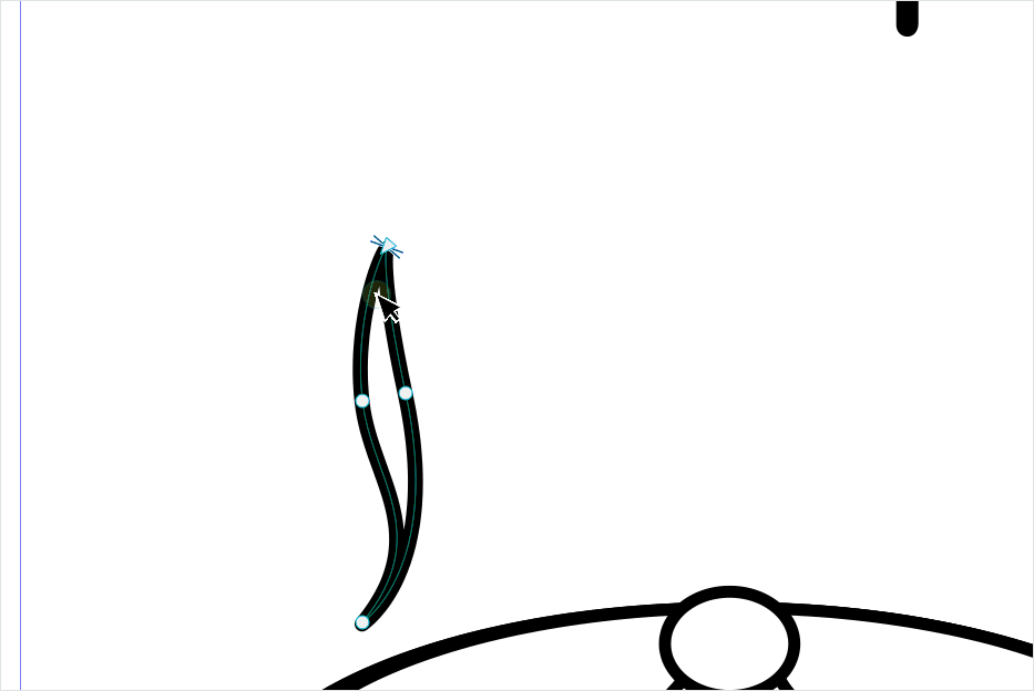

                    Discovered something else unexpected in the process after restoring the file (closing out and restarting). (And yes, those waveys were meant to be in Layer 1)
                    Shift + X causes the path to lose its original Stroke settings:
                    alt text
                    32GB RAM @ 6000MHz
                      VectorStyler @debraspicher
                      @debraspicher said in Occasionally Undo causes items in History and its related Objects to be lost:
                      Yes, the stroke is removed because there is no fill and the fill style is applied to the stroke.
