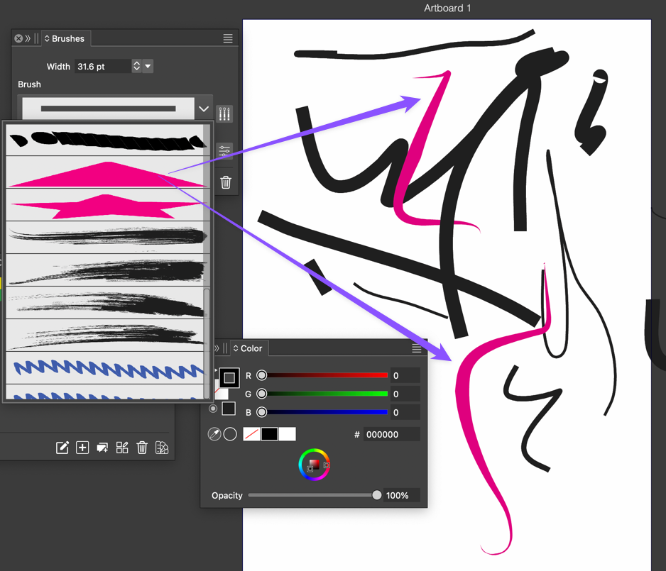

      Resizing the scale of the brush tool using the width option in the brush panel causes the brush panel to jump to a different saved brush in the panel. I also tried sizing it with the left and right brackets, but that works correctly and it does not shift to a different brush.
      Here is a long video of me experimenting to find the issue. In this case, it switched to an existing pink triangle shape brush I have saved in the brush panel. It happens a few times in the video as I narrow in on the specific cause.
      0_1733575198147_babe1161-b65e-4867-8f35-65907a76e977-CleanShot 2024-12-07 at 07.39.26.png

                    I run into different issues with the brush panel on my desktop machine than I do here.
                    On the desktop, it wants to default back to a specific brush even though I tell it to use another.
                    Here on the laptop, it does not do that but I get the issue of it switching when I edit the width of the brush
                    Would it help to send the workspace files? or maybe I should set it back to defaults and test it here?
