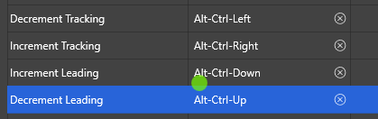

Adjusting leading using shortcuts is not working... instead it adjusts scaling? Ctrl + alt + left/right arrow accomplished the same thing.. after I came back, the Ctrl + Alt combos stopped working completely.

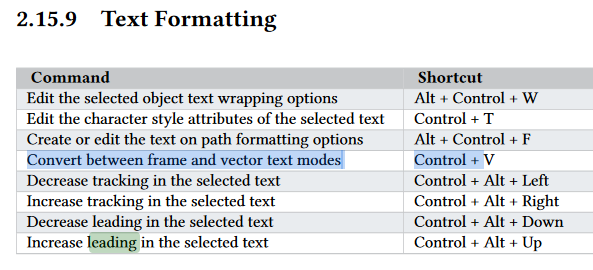

Note the shortcut for Frame/Vector Text Mode Switch is "Ctrl + V" .. might be interfering with Paste...? I didn't find it in the shortcuts though when I searched it.

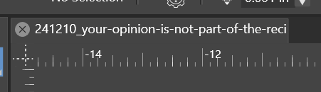

Unrelated, but should the filename be truncated?
Went to reassign. Well, that explains that...
Edit: I changed them to Alt + which is in line with other programs... Mac also seems to require the Ctrl + modifier, so it may need looking at as well if it is a duplicate.

@debraspicher I have to review these shortcuts as there seems to be some conflicts in the defaults.
The Control+V shortcut in the documentation is an error (it exists only on MacOS, not on Windows).The current leading adjustment refers to selected text (character leading), so you need to select the text
@debraspicher said in Text Shortcuts not working:
It is truncated, maybe it is too long? but the file name info is needed.

@VectorStyler said in Text Shortcuts not working:
I think it's fine that it's truncated, but maybe add "..." so that it shows as intentionally truncated... as long as I can hover over and see the full name, I'm good.
The Control+V shortcut in the documentation is an error (it exists only on MacOS, not on Windows).Are we 100% sure on that? Just because I was testing the Ctrl + V shortcut to see if it even worked at all and that's how I ended up with the Text Frame item. I suspected it was something like that where that shortcut worked, but I couldn't find a way to remove it. It's possible I pressed T multiple times to try to get back into Text mode and it may have moved me into that mode. I'm still not familiar with how those commands stack. Whatever the case, that's not good if we can't easily tell what is causing it to be uneditable. Especially seeing as we can sort of trigger the behavior to prepare for text editing (pre-highlight UI behavior) and nothing happening, it just feels like a bug when it behaves this way.
Control+V is pasting on Windows. I meant the text frame conversion shortcut only exists on MacOS.
