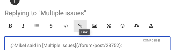

                  Boldline @MikeI
                  @MikeI said in Multiple issues:
                  I tried including an .mp4 video showing it but it doesn't allow the type.
                  If you want to include video files, one way to do it is to host it online and then include the link to the file on the forum
