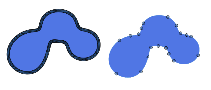

            If you remember, you once asked me what
            an object created this way would look like when exported.
            I've had a chance to try it out in the meantime; such a result
            can be exported as an .SVG file, though it contains a large number of nodes.
            So the VS simplify feature was a great help.
            Here a Pic
