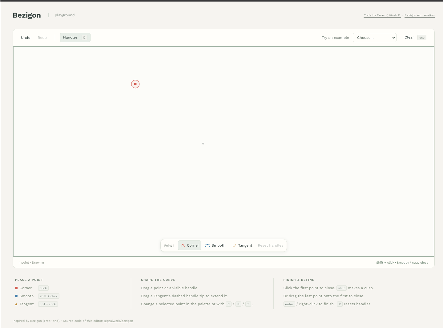

            Boldline @Daniel
            @Daniel I'm not seeing those options to toggle at the top (or anywhere). is there something I have to press or do?

            • DanielD Offline
              Daniel @Boldline
              @Boldline: That's not mine. That was done by another user. https://drive.google.com/file/d/1BDM-JtO3t5E3_iCCTFpNOw5Xa4DwZwM-/view?usp=sharing - Mine is here. πŸ™‚ It's a .exe file on Windows.
              The online one runs the 4.2.0 V with three node system. There's no ghost lines or circle mode.
