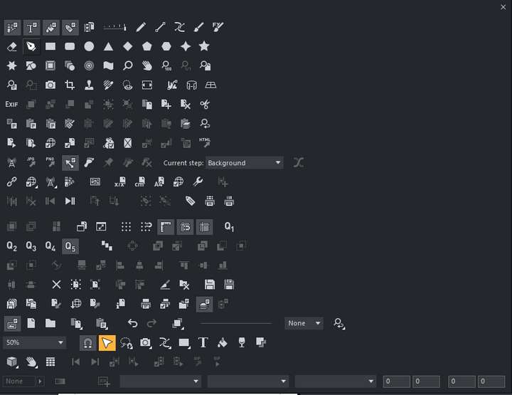

                    @VectorStyler: Sure, please do. You'll find it under Windows >> Control Bar >> Button Palette. The last option in the list. And you'll get this. 0_1743593287956_55b5abbf-155e-48aa-ab26-e5b7db924b8d-image.png
                    Second item on second row. Hold down Alt and pull into your tool bar.
                    Here's something else that's quite cool about Xara. You can hold down Alt and pull most icons and place them into your toolbar.
                    However, I don't think it was because of the complicated UI. I think they made a deliberate choice to promote the Shape Tool, which is extremely useful for organic shape drawing.
