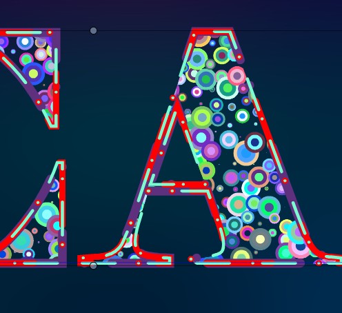

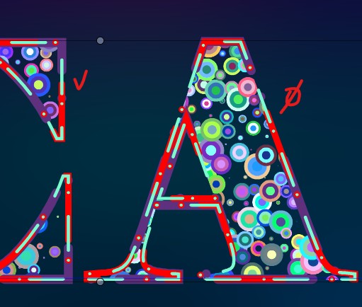

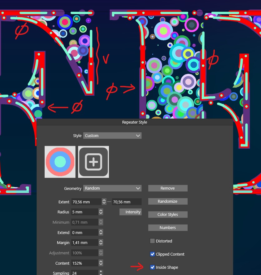

      I thought that by clicking on ‘Inside shape’, repeated objects were not allowed to overlap container boundaries. I only see a change on one side of an object. Either I forgot to change a parameter or it's a bug.
      Before:
      After:

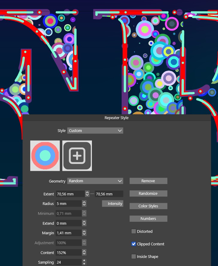

              @B-Vs-V I got the file. The issue here is that the "Inside Shape" option considers the symbol center for insidenes test.
              I will try to improve this.
                VectorStyler @B-Vs-V
                @B-Vs-V Set the Expand amount to 0 (this expands the shape), and enable the "Restrict Using Shape" option.
