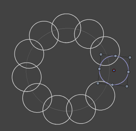

            • encartE Offline
              encart
              Works well now, thank you!
              There is one small issue. The center point of original object is not attached to path when scaling. Clones behave properly. My solution for now is to use Scale Tool, but maybe you'll see some chances for improvements.
                VectorStyler @encart
                @encart said in The cloned object causes incorrect positioning when placed on the path.:
                This is not possible with the current version as there is no link between the objects and the path (to keep positions).
                But this will be available in 1.3
                encartE 1 Reply Last reply Reply Quote 1
