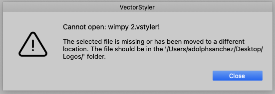

This on a mac, after I open a file it does show up in open recent, but I get this:

Same thing, can not find the open recent files.
@asan said in open recent Help:
Not clear why this happens. It seems that VectorStyler cannot access files in the /Desktop folder.
I will try to find out more on this.

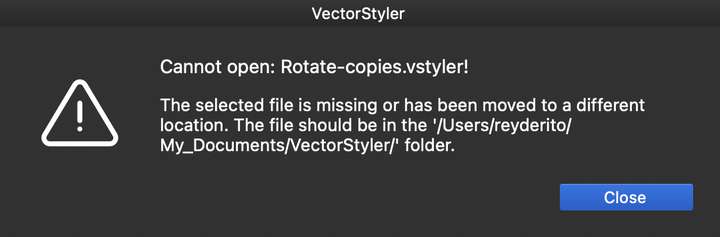

I am having the same issue. Open recent menu lists recent files, and will open them as long as I don't quit VS. If I quit, relaunch and try to open any saved file listed in Open recent, I get the attached error message.
I am using VS Version 1.2.071 on Mac OS Sequoia 15.5
@Reyder I have a bug opened on this issue. It looks like some sort of permission issue (new MacOS versions introduced a lot of permission blocks). I will try to replicate it.
@asan A question: are you using the Mac App store version of VectorStyler or the one downloaded from our webpage?
I am using the Mac app store version
That explains the issue. The Mac App store runs apps in a mode that cannot access files in folders, unless manually opened.
