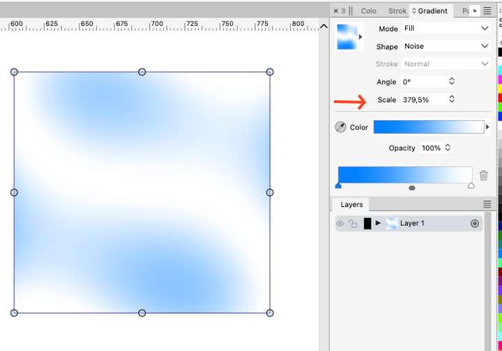

      I am a new Vector Styler user and am really loving this tool. There are many things I still don't know about this application, so maybe this bug report isn't a bug. Please let me know if there is a way to achieve what I am trying to achieve.
      I want to apply a gradient with noise shape and change the scale of the noise pattern. When adjusting the scale setting on the gradient panel, no change is made to the pattern itself.
      I've attached a short video to describe the issue. I hope it's fine posting video this way. Please let me know otherwise
      Thanks
      [0_1747672985031_noise gradient scale.mov](Uploading 100%)
        VectorStyler @EricP
        @EricP Yes, it can be replicated here. The Scale (maybe should be named Stretch) value is not supported by the Noise mode.
        I opened a bug on this to find a solution.
