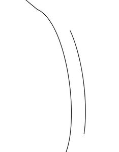

      I'd like to be able to add an offseted path locally using the Offset Path Tool.
      The tool currently deforms the existing path and removes the original path. I'd like the ability to add a path with locally defined offsets, while keeping original path intact. I did not find how to do it.
      I guess there could be some usability challenges, like for instance adding another offset on top of existing one (desirable). I think we could convert to curves before adding a new offset on top of first one. Only the newly created path would remain editable with offset control points

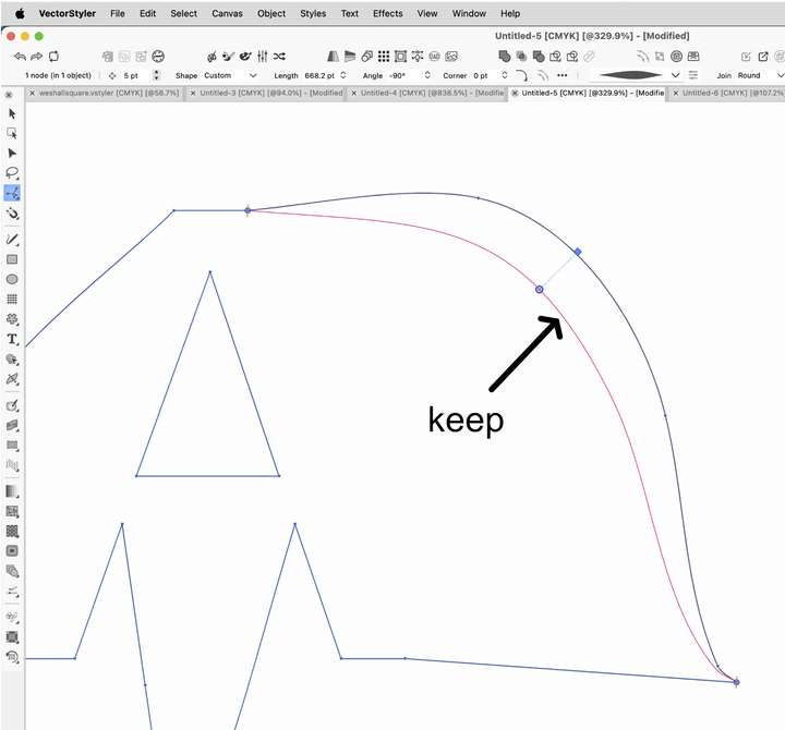

              Copy a Part of a Path works only with open Paths.
              Here a Pic
              Select the all Nodes of that Part then you could use
              Menu > Object > Transform > Move (Mode copy)
