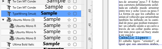

Im testing. Appear to be that with at least some fonts, the preview showed in the Panel is not the same that applied to the text. Look at this screenshot. The font used in the text frame is right, while the sample in the panel not

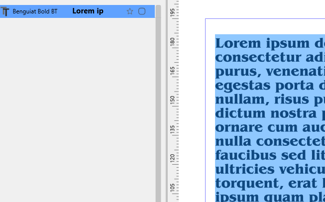

@marce confirmed with a well known font i use everytime, the sample is different than the real font
