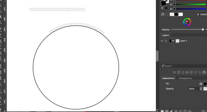

Tibetan fonts are displayed as squares only.
hi,
as I am using Vector Styler to draw also with other fonts than roman, I use Tibetan fonts and characters.
unfortunately Vectorstyler draws them as squares only.am I doing something wrong?

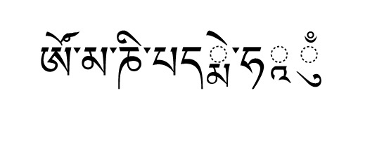

it looks like this:

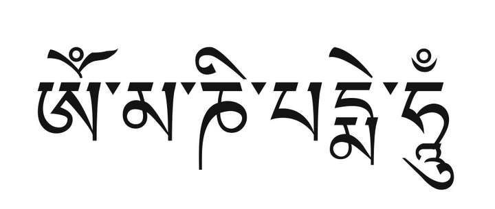

but it should look like this:
somehow the characters are not stacked correctly.

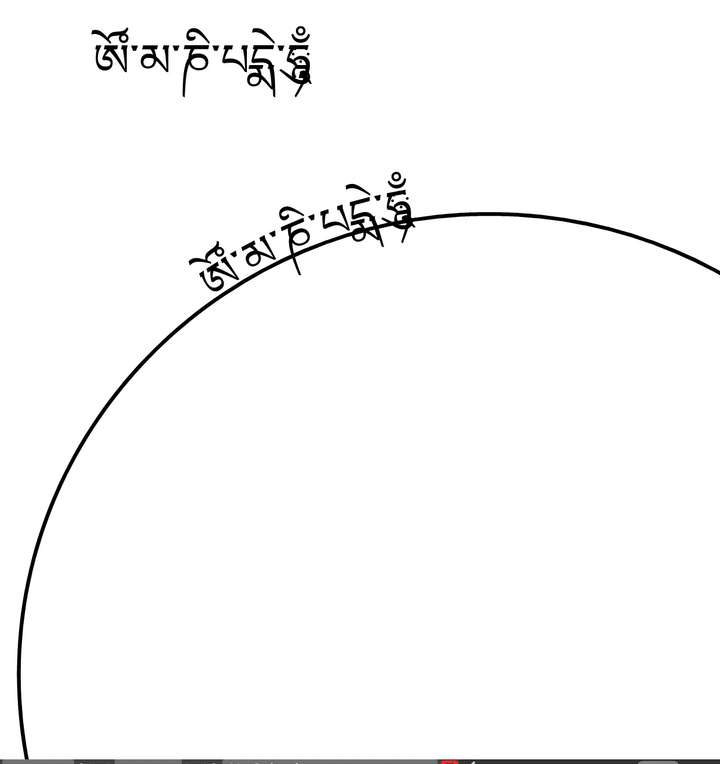

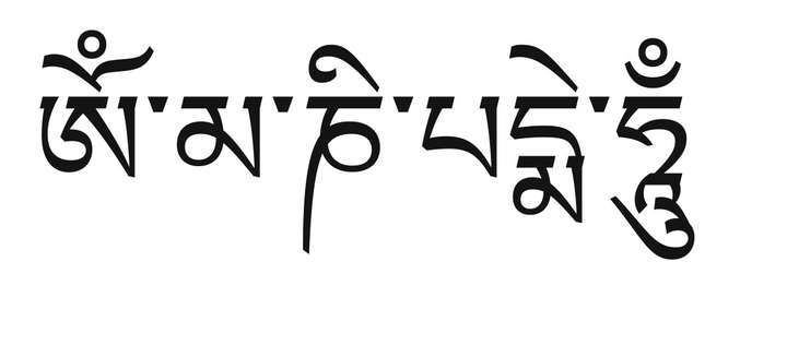

The font is called noto sans Tibetan (by google)Kailasa font is looking even worse:
but should look like this:
of interest could be that the standard textedit app on OS X can get this right, so it should be an integrated text function to draw the characters correctly.
On the other hand, VectorStyler shows promise because it keeps the accents on top of the characters also in the wrapped text on the path.
Amadine fails.
