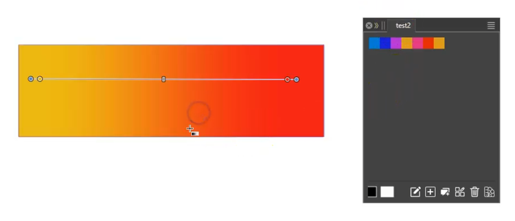

          @Subpath or simply :
          • select multiple colors from palette and drag them onto the gradient panel : places them in the order selected on gradient scale
          • alt-drag : add additional colors to existing gradient as more stops, including already used colors

              After further attempts, I understand your suggestion that
              colors from the color palette can already be transferred
              to an object with a gradient via drag and drop.
              Dragging and dropping selected colors from a palette into
              the gradient editor doesn't work.
              At my first attempts i was slightly misleading because the
              object with the gradient initially became a solid fill at first.
              However, when you then apply the gradient via the gradient tool
              to this object again, the gradient with the selected colors appears.
              So, thanks for this tip.

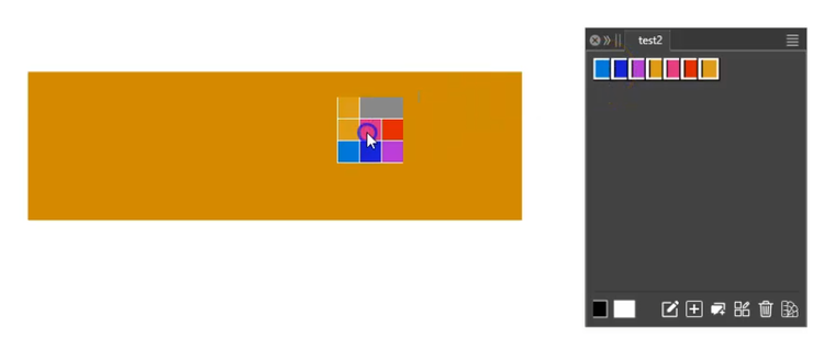

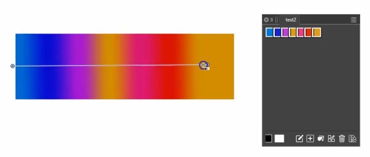

                Subpath
                Here a step by step guide for other Users:
                How to use colors from a color palette for gradient colors
                Create or select an object with a gradient.
                Select the colors in a color palette while holding
                down the Shift or Ctrl key (Windows).
                Drag and drop the colors from the color palette onto the object
                with the gradient.
                The object's fill will change to a solid color.
                Drag the gradient again with the Gradient Tool, and
                the gradient will now display the colors you selected.
