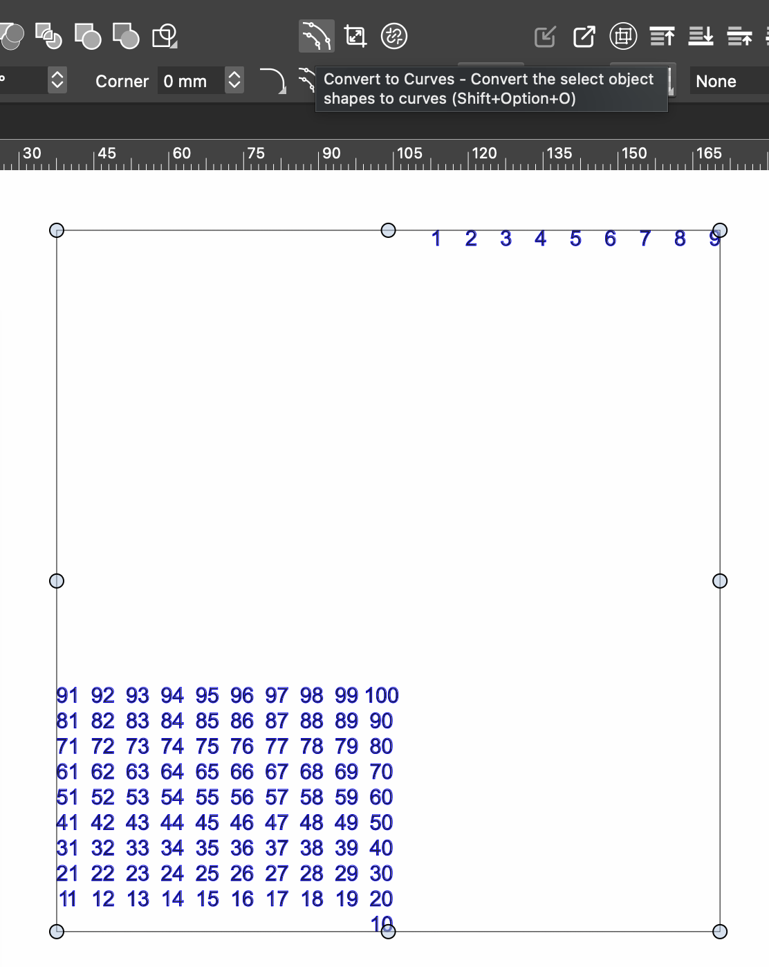

          @VectorStyler The issue is fixed in 1.3.021. However, when I use the 'Convert to Curves' function on the expanded text, the numbers 1-9 shift to the top right.
            VectorStyler @Li Xiao
            @Li-Xiao I will open a new bug on this (probably a different issue)
