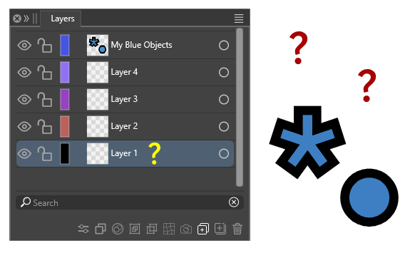

      Sequence (Images below.)
      • 1 Create two or more Layers and put some objects on them.
      • 2 Select one or more objects.
      • 3 Click a target Layer in the panel to make it Current
      • 4 Select Object::Arrange::Send into Current Layer
      • Objects are sent to Current Layer successfully
      • Repeat steps 2-4
      • Objects are killed, Undo does not return killed objects.
      Sometimes the objects are gone, but the Artboard graphics remain visible.
      Sometimes the application must be restarted to return the Send functionality.
      The sequence seems to create some kind of corruption.

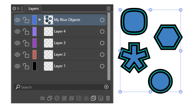

      1 Layers and Objects

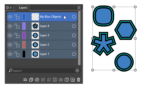

      3 Select target Layer

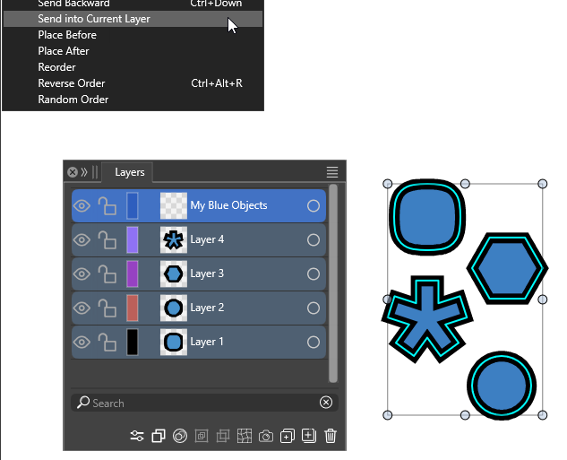

      4 Send into Current Layer

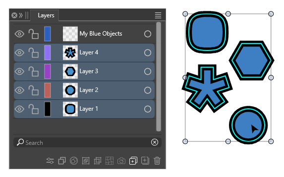

      Objects sent successfully
      Select again, send to another Layer

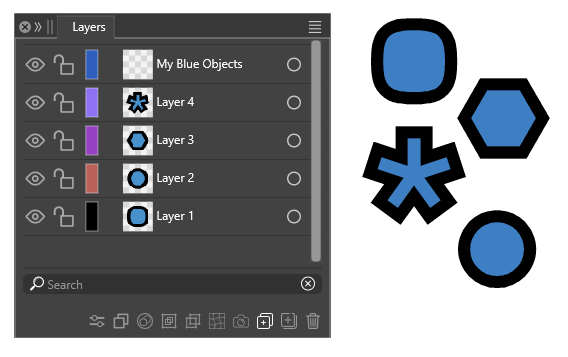

      Poof, gone...
        VectorStyler @larsherold
        @larsherold Looks like a bug, I will try to fix this as soon as possible.
