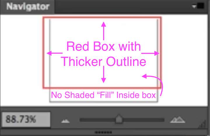

          In my Post in the New Features and Ideas section titled "Improved Navigator Panel Slider Bar and added Navigator Icon", I mention that Adobe Illustrator uses a Red Outline colored Rectangle Box to show the Zoom Position. It has a thicker stroke than the thinner Black outline that VectorStyler uses around its box. Illustrator also doesn't have any Shading "inside" the Red Outline of the window either (see image below).
          Both the Red color and it being thicker makes it easier to see. The Shading in VectorStyler might be a hinderance to visibility as well.
          When at maximum zooming, Illustrators Red Rectangle Box becomes so small it looks like a "dot"; but despite it being a tiny spec, the Panning Hand Icon can still "detect it" and it can "grab" the red Dot and so you can Pan and move around.
          Here is Adobe Illustrator Navigator Panel showing its Thicker Red Outline and No Shading in the Box:
          0_1625286998571_Adobe_Illustrator_Navigator_Panel_Red-Box_Screen-Shot_Annotatated.png

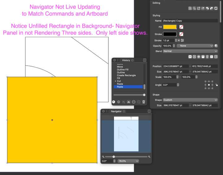

          @vectoradmin,
          I sent you a VectorStyler File and Screen Shots showing the Navigator Panel not live updating to match the what is displayed on the Artboard and with some Rendering problems.
          VectorStyler also Crashed shortly thereafter.
          0_1625282509752_VectorStyler_BUG_Navigator-Panel_Not_Updating_Live-To-Match-the-Artboard_1_Annotated_Screen-Shot_11-Inches-Wide.jpeg
