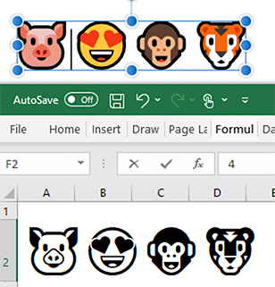

            Yes, but should not COLR fonts, too, have fallbacks, so this what you get if you have an app that supports color version, and an app (like Excel) that does not. Copying color versions on the Clipboard and pasting them in Excel produces fallbacks (which can be seen by the fact that they are separately drawn b&w versions, not just color versions in black and white):
            So currently in the Windows version. of VS, if I tick "Monochrome" in the Character panl, instead of getting those fallbacks, I'll get something else (but I am not sure what, as typing in e.g. "8" (that I get as a monochrome for the "Sad face") from the keyboard in other apps that support Segoe UI Emoji COLR font, will not give me the "Sad face", but just "8".

              @Arde I open a bug on this one, and try to solve it. I'm not sure yet how Excel gets to those glyphs. From the screen shot, it just seems the same, but with thresholded black and white colors.
