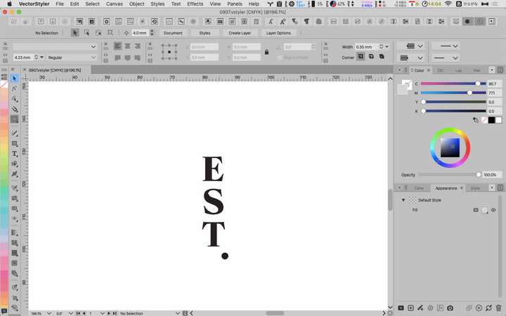

      After I type out text I want to ultimately be vertically placed (#1), if I go to Text>Vertical Text, it makes it look like #2. Is there an option to have it look as it does in the next image?

            @861475_VctSt @Boldline I completely misunderstood the original question. (the text should not be rotated).
            With East-Asian options enabled, there is an "Auto Vertical Roman" option in the Japanese options of the Text -> Character Options view.
            When enabled, Roman text is rotated automatically in vertical mode. Disable this option to have the text vertically but with normal orientation.
              @vectoradmin said in Vertical Type Options:
              @Boldline Rotating the horizontal text by -90 degrees

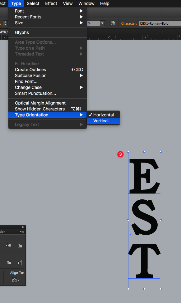

              @vectoradmin You may have misunderstood my question. If you look at the text in the second picture marked #3, the text is facing upward like normal, but it's in a vertical stack. This is what I was expecting with the vertical text option

                    I appreciate the different methods to achieve vertical text. I love the flexibility of direction and control is built in to VS. That said, there's an option available in VS for "vertical text"already built in that only rotates the text box 90 degrees. If I'm wanting text running vertically like this, I'm not going to go look for the "vertical text" option in the menu - I'm just going to grab it and rotate it.
                    What @encart demonstrated is great and I'll use that in the future - but that's a multi-step process and so to me, having that result be what defines "vertical text" makes more sense than just doing a simple rotate of the text box.
                    Here I am demonstrating the process in Illustrator. Text like this is most commonly how I do vertical text.
                    In summary, I don't see the point in having the "vertical text" option listed at all, taking up space in the menu if all it does is a simple rotation of the text box. At least the option Illustrator gives is one click to accomplish a 2 step process. My vote is for making the vertical text option like what Illustrator offers
