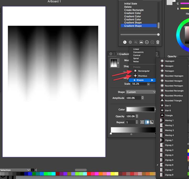

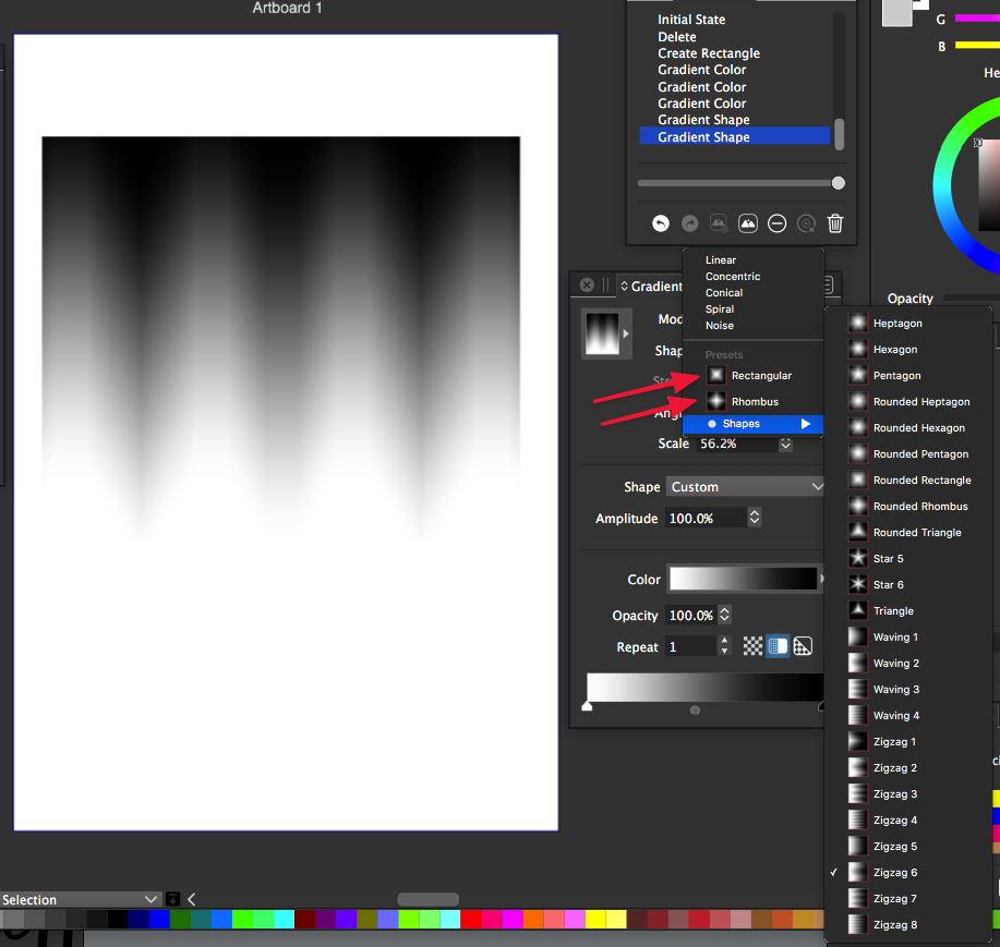

      I was playing around with gradients and halftones today. When I had a gradient selected and was in the gradient panel, there's the option to change the shape and below that is a "shapes preset" menu... but there are two presets sitting above it. Would it not make more sense for these to be included inside the "shapes" sub-menu and not sitting outside of it?

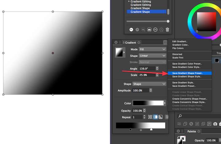

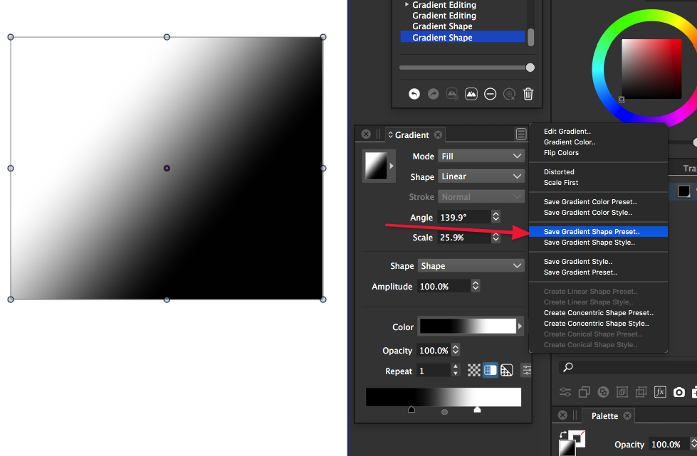

      Could we also go into how to add out own presets into here? Is there a way to add an additional folder below the "shapes" one? or inside there that we could add out own into? I tried making my own and saving it as a "gradient shape preset" but I did not see it listed there. 0_1632603600339_e899c3e1-681d-42df-b032-58ca6d76c5d2-image.png
        @Boldline When creating new presets, these are added to the root of the group (specific to the preset type).
        The Panels -> Presets -> Presets panel, or the Styles -> Preset Manager view can be used to place these into folders, or to create new folders.
