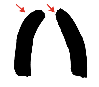

      If i mirror/flip an Artistic Stroke in VS
      the shape is not mirrored.
      Only the direction of the stroke.
      I sketch a line with an Artistic Stroke
      then copied as reference
      and mirror/flip one of the strokes
      and the result is like on the picture.
      But I would like the shape is also mirrored.
        VectorStyler @Subpath
