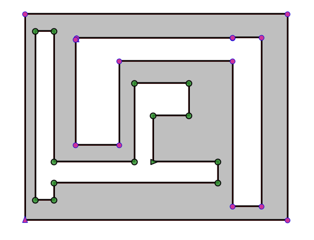

  • Is it possible to select the entire path inside an object? For example, I select one node of this path and use a keyboard shortcut to select all within it.0_1634940235317_screenshot_20211022_235730.png

  • @vectoradmin I've tried this before. All are marked then. I meant to mark the green nodes but without marking one by one or
    using lasso tool. Just were curious if it is possible now.
    @encart If that is a single object, then the only way to select the green nodes is to use the lasso tool, or Shift+Click.

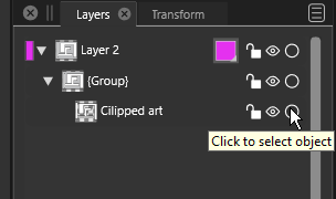

    It is possible if you were to use the Shape Editor tool.
    1. Click on the Shape Editor tool

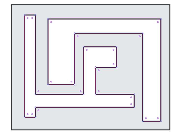

    2. Use the Layers panel to select (refer to attached image - Stage A _Layers panel.png) and you will get results as in attached Stage B image.png

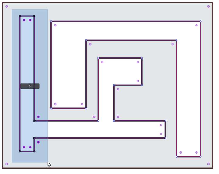

    3. Then select the first 6 nodes of the artwork (refer to attached image - Stage C.png)

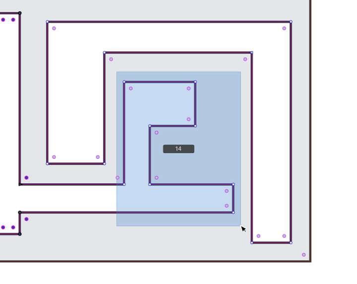

    4. Finally you Shift + select the remaining 14 nodes of the artwork (refer to attached image - Stage D.png)
    The clipped artwork is now all selected.
    0_1634985321152_Stage B .png 0_1634985335643_Stage _C.png 0_1634985347823_Stage D.png
