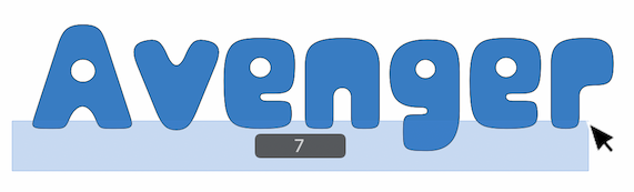

            b77 @Boldline
            @Boldline Are the small white shapes grouped with the letters? If they are not, dragging the selection box/marquee over the lower part of shapes β€” just touching the blue ones I want selected and avoiding the white ones I don't want β€” should not select all of them:
              Boldline @b77
              @b77 thanks for the visual. That works if the letters are not grouped. In my example, it's basically one shape with several negative spaces within... the negative spaces are "grouped in" by default. I was hoping there was a way to click once on the shape and only change the color of shape and not affect the grouped in negative spaces... that might not be possible.

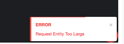

                      I'd be happy to upload the files to make it easier, but each time I've tried that, the upload fails, even if the file is well under the size limit for upload. I had reported this to @vectoradmin a while back. He was looking into it bt I have not tried it again recently.
                      Have you had success uploading files to the forum?

                          @b77 If I try to send your own file back to you on the forum, that uploads correctly. When I tried just now to send my file to you (1.4mb), it failed...

                              @Boldline Got it, indeed 1.4 MB is too much and won't upload. But you could just paste that text into a new file and I guess it will be much smaller than 1.4 MB.
                                Boldline @b77
                                @b77 The forum is supposed to be able to handle files even larger than 1.4MB being uploaded... However, you make a good point I could move it over to a new file. I had tried removing the source photo I had embedded in the file and re-saved it and it retained the same file size even then, so that was odd. Making it a new file with just that part proved far better.

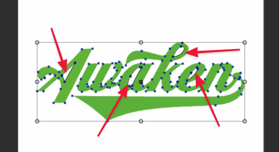

                                0_1635011843148_Awaken test.vstyler
                                The letters are green fill only but the negative spaces have a black outline that appears when selected...I know this is tied to the layer color being black and any selection made will be in black for that reason, but why are only those negative space areas showing that layer color outline?
                                b77B 2 Replies Last reply Reply Quote 0
                                  b77 @Boldline
                                  @Boldline As I suspected, the "white" shapes (actually they have no fill) in the group overlap identical holes in the green text beneath – that's why when you select them all and change color they also get the fill and cover the negative space.
                                  Double-clicking inside the group and selecting just the green shapes to assign a different fill works, and you can also use 'Invert Selection' and delete the unneeded shapes with no fill.
                                  Quick video here: https://recordit.co/BT1RDj1CXs
                                  Question is, how did this happen? Just converting editable text to outlines should not result in these double shapes covering the negative space of the letters. Maybe the text object was pasted from AI?
                                    b77 @Boldline
                                    @Boldline said in How do I quickly change the color of a shape with negative spaces without automatically filling them as well?:
                                    […] but why are only those negative space areas showing that layer color outline?
                                    The app highlights the contour of objects when you hover them, so you know when to click-to-select, and because those are separate objects that are not part of the green text (they just overlap it) they get highlighted separately from it.
                                      Boldline @b77
                                      @b77 said in How do I quickly change the color of a shape with negative spaces without automatically filling them as well?:
                                      Yes I had made this in AI because my attempts in VS failed earlier when the font I used caused problems in VS.
                                      If I import vectors with negative shapes from Illustrator, I'll have to be checking that I've removed the extra no-fill shapes it adds in. I appreciate the video
