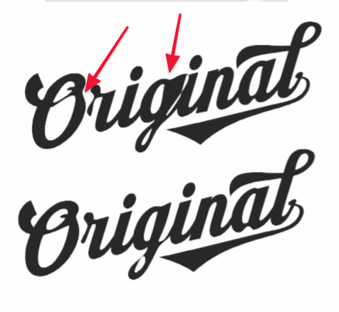

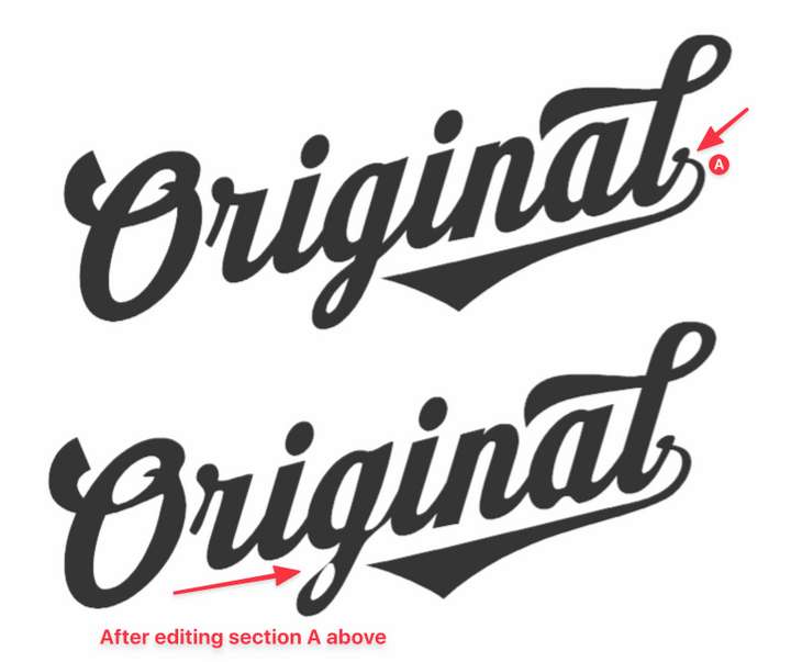

      I was trying to clean up the nodes and tighten things up in the area marked "A" on the far right side of this text shape. The entire thing has been united using union prior. After making the adjustments, other areas of the design get negatively affected - like the lower section of the "g" and other areas as well.
      Is there a setting I need to adjust to fix this from happening?
        @Boldline Was this imported or pasted from AI? It could be that the type of the node at stem of the "g" is wrong.

          @vectoradmin Just emailed you the file. The file is getting even crazier as I was prepping to send. Just moving around and pasting the original in place to send over - look at the results of that! I can't get it to go back to how it looked in the picture I sent initially in this thread

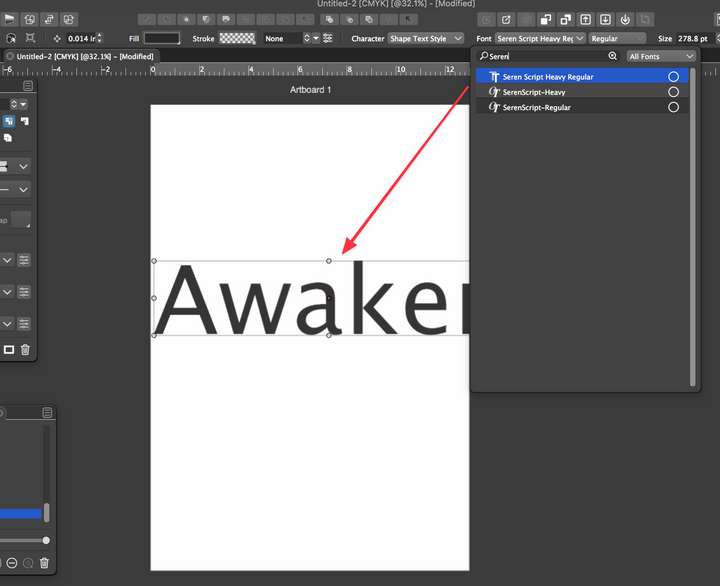

                    @vectoradmin When I went to type out a word using that same font in VS, it did not register correctly. At first it showed nothing, the second time I tried, it gave me a default font (not the correct one) - the other two in the font list do work properly

                      This is an issue I have been struggling with for a few releases.
                      But I still don't know where it comes from. Sometimes while working, the fonts disappear from the font list, or the name on the list does not match the font. Usually restart helps.
                        VectorStyler @encart
                        @encart I will try to replicate this with that font.
