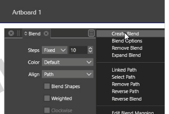

if i create the Blend from the Blend Panel Menu
it works es expected. But if i use the Blend Tool
for that it put the Blend on the latest Path.Video
Blend Panel Menu
@Subpath This looks like a bug. Does selecting "Remove Path" from the menu fixes this?
@vectoradmin
no, it does nothing.
my workaround is, to use Blend from
the Panel Menu, or i convert the Curve
to straight line with the Shape Editor Tool.
