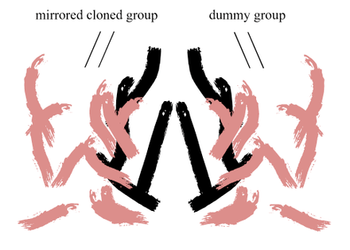

      Creating symmetrical Designs with shapes is easy to do in VS.
      With Clones and Symbols.
      But did you know that you can also sketch symmetrically?
      Note:
      This works only with a cloned group, but it works. 🙂
      This Video shows how it works, re-upload
      First create a kind of dummy Group. Place this Group
      anywhere on the Canvas.
      Then clone that Group and mirror it to create a simple
      symmetrie. Of course, you can sketch with any symmetrie
      you like.
      Select your original group then select the "Draw Inside" Tool.
      Select your sketching Tool and up then you can start sketching.
      As your original and the "Draw Inside" Tool is selected all Strokes,
      Objects will be placed "inside" of your group and appears also in your clone too.
      Note about vector Brushes:
      To sketch with the vector Brushes, one additional Step is needed.
      Open the Document Setup ( Menu > File > Document Setup )
      and set the "Transformed Stroke" Flag. This enable that the Brush
      Shapes will be mirrored correctly.
      At least if your clones will loose there link to the original.
      Delete just that unlinked clone Side. Select your original group
      Side and create a new clone from it and continue sketching.
      It is also possible to create other symmetries with the same Sketch.
      Select your original choose Transform "Rotate" or "Transform" and
      set your repeats. ( Menu > Object > Transform ...)
      Select your orignal and the "Draw inside" Tool and continue sketching.
      Btw. the "Select and transform Members of a Group" Tool is helpful
      if you like to move one or more strokes.
