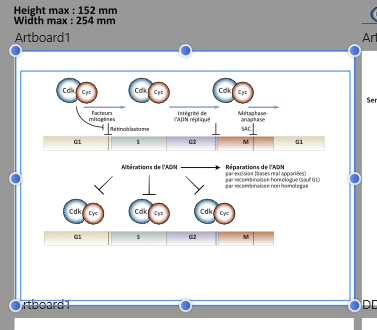

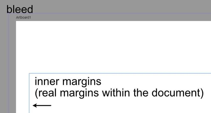

        @b77 thanks. I did find the Artboard tool that allows resizing etc; but my questions are more related to the document specifications.
        This screenshot shows the margins in a template/document :

          @PatrickM So inner margins would be a visual help for the user to keep an empty area around the objects, area that get included on export?
          • B Offline
            B-Vs-V
            @b77 yes for the visual help & I don't know yet for including it on export in VS. In other apps one can decide to export only the scheme and not all the artboard. Margins are very useful when vector graphics/schemes have to fit into a canvas and respect certain dimensions to avoid enlarging or shrinking them afterwards.

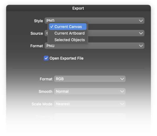

                  Also: in the Export window you have options to export the current canvas, current artboard or only the selected objects:
