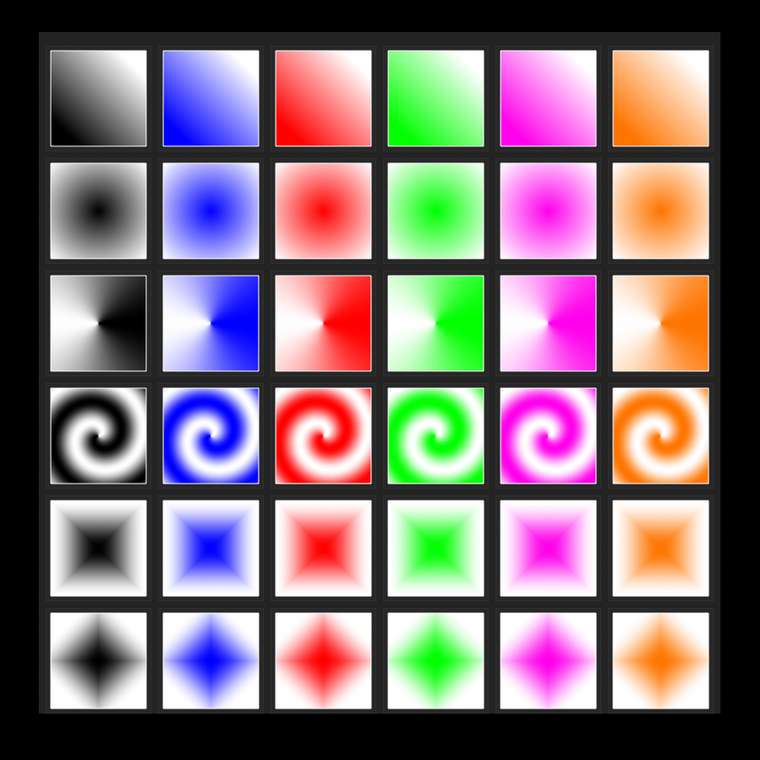

Just looking at the video it appears so that when you open the popup list of gradient presets from the panel, it does not show some gradients. Linear and radial are visible, but not the others.
It could be that gradients are not displayed for some reason on your machine.
One way to test this is to change the Compute Engine mode to "Software" in the Prefereces -> Performance section.
restart and check if gradients work in that case. -
When you open the gradient list in the panel, it should look like this:
