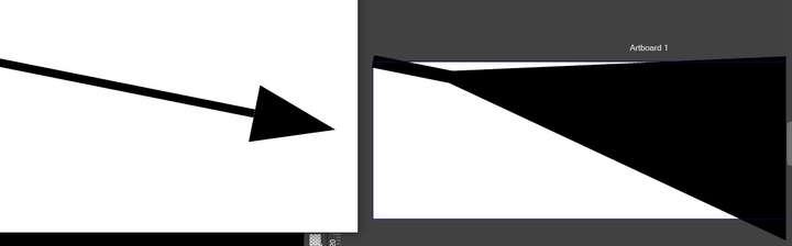

I had problems in the past with existing arrows in a svg file and the rotation/size at the marker-end. Must be checked with marker-start, marker-mid, too.
for example:
<svg xmlns="http://www.w3.org/2000/svg" viewBox="0 0 350 100"> <defs> <marker id="arrowhead" markerWidth="10" markerHeight="7" refX="0" refY="3.5" orient="auto"> <polygon points="0 0, 10 3.5, 0 7" /> </marker> </defs> <line x1="0" y1="0" x2="250" y2="50" stroke="#000" stroke-width="8" marker-end="url(#arrowhead)" /> </svg> -
@freggern Is this when importing into VS?
(or is it exported by VS?) -
It happend when importing the svg to VS.
left(Firefox), right(VS) -

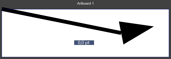

Thx for fixing the drag und drop on windows. I found a new issue: When you create a new document and add the arrow-file per drag and drop to the empty document it will add the arrow with the wrong rotated head. Open it as a "new file" per drag and drop work correct.
Scaling of the arrow doesn't work as aspected:
@freggern said in SVG compatibility issue:
When you create a new document and add the arrow-file per drag and drop to the empty document it will add the arrow with the wrong rotated head.Replicated this one. I will keep the issue open.
This can also be replicated.
