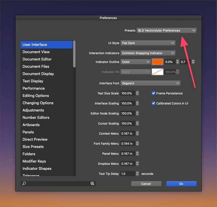

      In the preferences folder, if I create my own custom set of preference settings, the name is listed in that spot. (see second screenshot below)

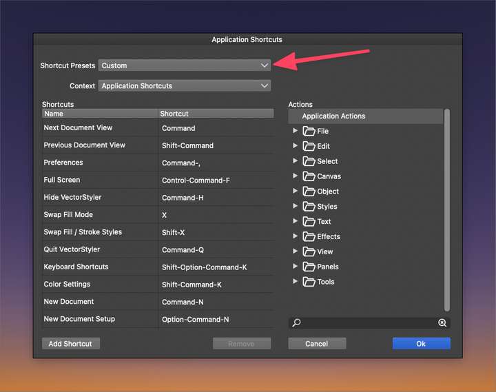

      I'd like to see a similar way set up with application shortcuts - so it's not just saying "custom" and I'd be able to know exactly what file is being used

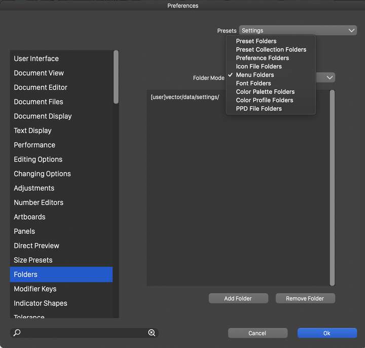

        @Boldline The files that are listed in that drop down are searched automatically from specific folders.
        In this case add a new folder (with "Add Folder") to the "Menu Folders" list of folders. This can be used to point to folders where menu, toolbox or shortcut customization files are saved.
