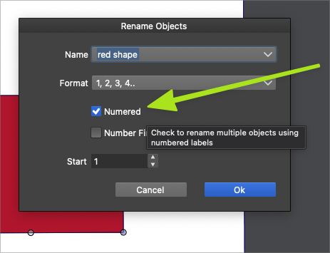

      Also, there is still what appears to be a spelling error in the "rename objects" panel unless it's a word I'm unfamiliar with.
      Should "numered" be "numbered"?
      0_1642807008447_23cec112-2891-49e8-852c-5751b16028de-BLD 2022-01-21 at 18.00.40.png

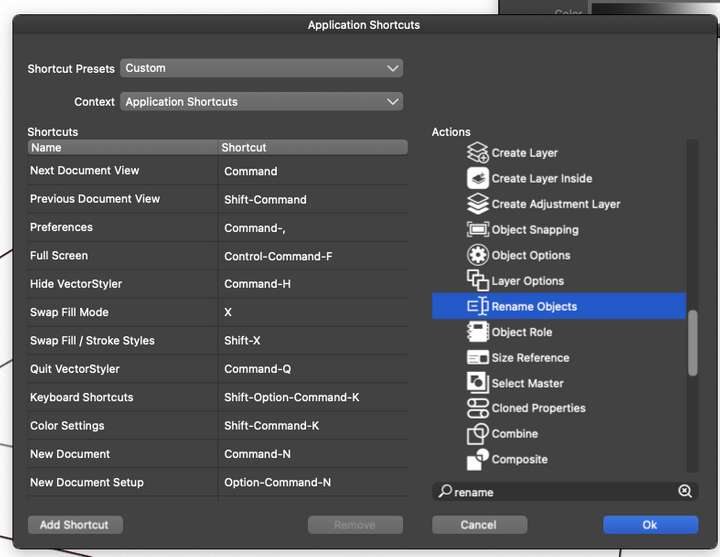

            Not enough to burn a quarter of a calorie! πŸ˜„ But hey, look at another option Mr Shortcut πŸ™‚
