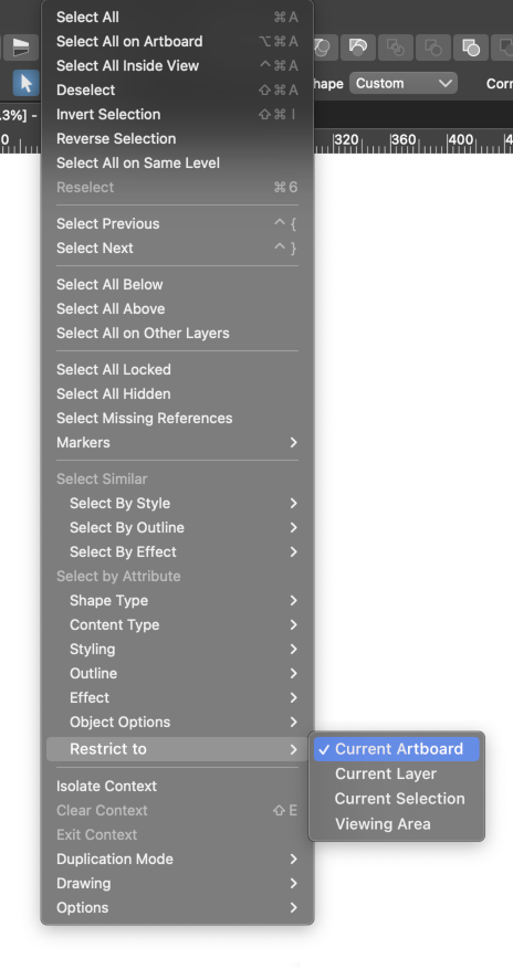

                    b77 @Ingolf
                    @Ingolf I agree, the search scope for these is not something to be hidden in the bowels of the Preferences.
                    @vectoradmin I like it that VS has the 'Select by Style' and 'Select by Attribute' options "baked" into these submenus — it's faster than having a modal window with its dropdown menus and the 'OK' button confirmation.
                    Would these options placed in a separate submenu work for this?

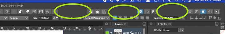

                      Boldline @b77
                      @b77 I agree with you that it should not be buried in the preferences, especially considering there are several great selection options as you listed in your mock-up. "Current artboard, current layer, current selection, viewing area, are all great options for this. If they are easily accessible, I would use each of them at different times in my work, knowing now that they are available/could be available.
                      Sometimes the select list feels a little cumbersome and lengthy. There are certain select options I use a lot more than others.
                      Would it also make sense to have the select options available at the top right? Just throwing the idea out there.
