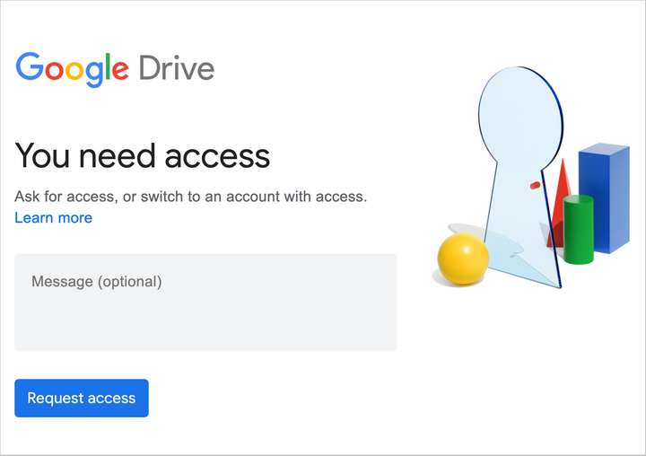

        Can you adjust the settings so we can access the video? thanks!

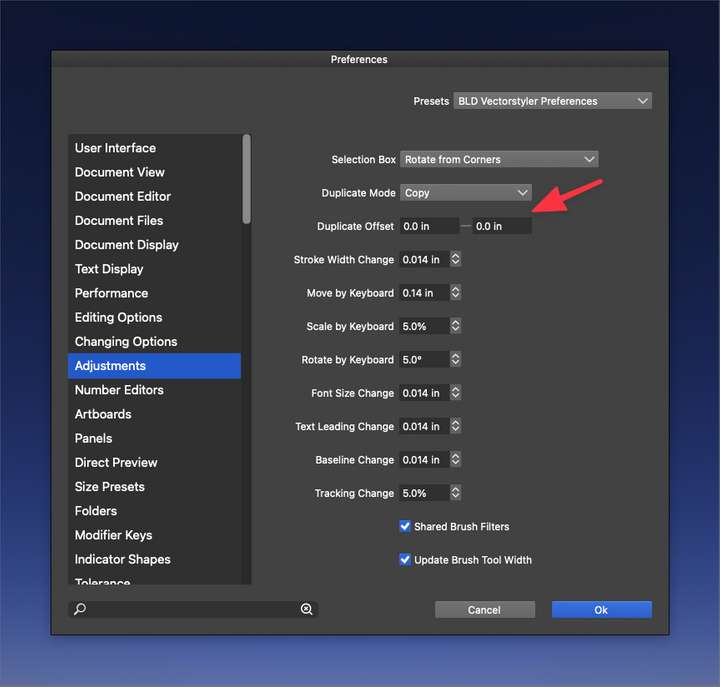

            I don't know about size discrepancies when pasting, but you can set the paste feature to have no offset at all and should paste itself right overtop where it was copied from.
            Here is the option in preferences. I have mine set to zero for that very reason.
            0_1646793572700_b1ee1678-fbf5-4926-a6b5-23de61fc466d-BLD 2022-03-08 at 21.38.02.png
            There is something to be careful with - if you move around your document more than just a little bit in-between copying and pasting the object, it will not paste in place. It technically "pastes in place", but it's in relation to your new location. @vectoradmin is working on an eventual fix (hopefully!) 🙂
