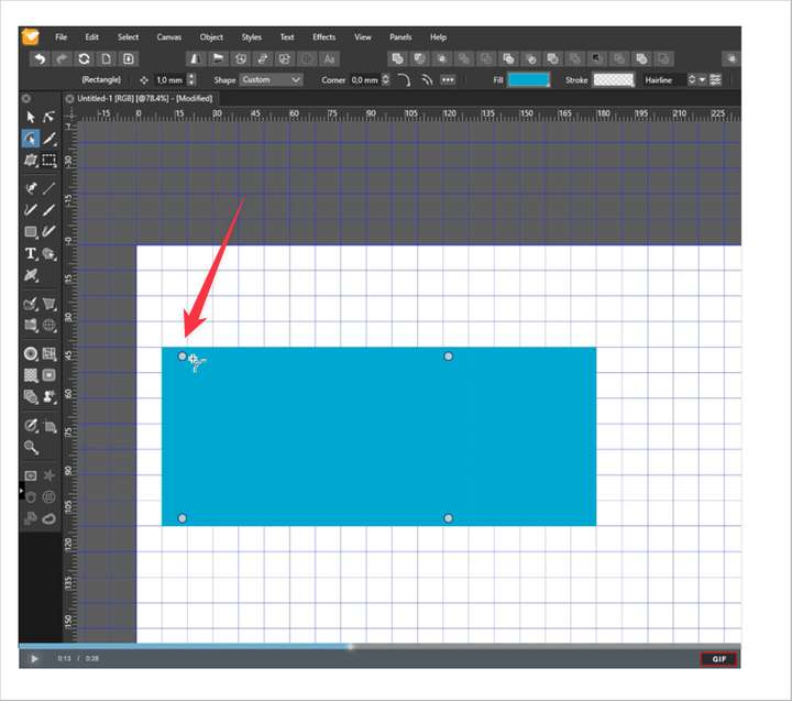

      I'm not sure how to describe that accurately and not sure if it a bug or intentional.
      https://recordit.co/4ExmjDuHq6
        Boldline @encart
        @encart What's interesting is that your corner indicators for the round corner tool are not set perfectly in each corner.
        0_1649514462850_b4448903-439e-486d-b603-55cda6a842ca-BLD 2022-04-09 at 10.27.17.png

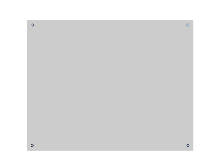

        Here is a regular shape and the indicators are aligned with the corners
        0_1649514539677_e57d5192-8ab6-4494-92dc-ee2ec5f1d105-BLD 2022-04-09 at 10.28.07.png

          @Boldline That's right. They change position depending on how the shape has been stretched. That is why I used Union.
            VectorStyler @encart
            @encart yes, this can be replicated. The issue here is that (for most shapes) scaling the object results in the addition of a "Transform effect" on the object (editable in the Shape Effects panel).
            But corners are applied to a shape before this (or other) shape effect.
            I will try to find a solution for this, in the case of transformations. A convert to curve (before adjusting the corner) flattens the transform, and the corner handles are back where they should be.
